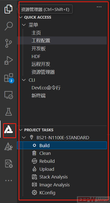

简单地说就是:VS Code+deveco-device-tool+DevTools_CFBB
VS Code用于编写代码。点击跳转
deveco-device-tool开发板编译工具点击跳转
DevTools_CFBBH2821编译工具链点击跳转
工具最好安装到C:\
vscode中会多出这个扩展,就可以进行工程配置,编译、下载了。

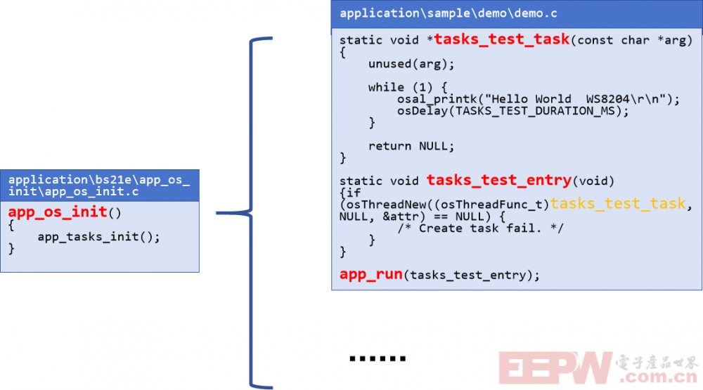

下面这个点灯的程序不是标准的写法,只是为了快速点灯验证。比较标准的程序是后面的demo。
1、app_os_init入口程序

4、DEMO
#include "common_def.h"
#include "osal_debug.h"
#include "cmsis_os2.h"
#include "app_init.h"
#define TASKS_TEST_TASK_STACK_SIZE    0x1000
#define TASKS_TEST_TASK_PRIO          (osPriority_t)(17)
#define TASKS_TEST_DURATION_MS        1000
static void *tasks_test_task(const char *arg)
    unused(arg);
    while (1) {
        osal_printk("Hello World  WS8204\r\n");
        osDelay(TASKS_TEST_DURATION_MS);
    return NULL;
static void tasks_test_entry(void)
    osThreadAttr_t attr;
    attr.name = "TasksTask";
    attr.attr_bits = 0U;
    attr.cb_mem = NULL;
    attr.cb_size = 0U;
    attr.stack_mem = NULL;
    attr.stack_size = TASKS_TEST_TASK_STACK_SIZE;
    attr.priority = TASKS_TEST_TASK_PRIO;
    if (osThreadNew((osThreadFunc_t)tasks_test_task, NULL, &attr) == NULL) {
        /* Create task fail. */
/* Run the tasks_test_entry. */
app_run(tasks_test_entry);
void app_os_init(void)
    app_tasks_init();
