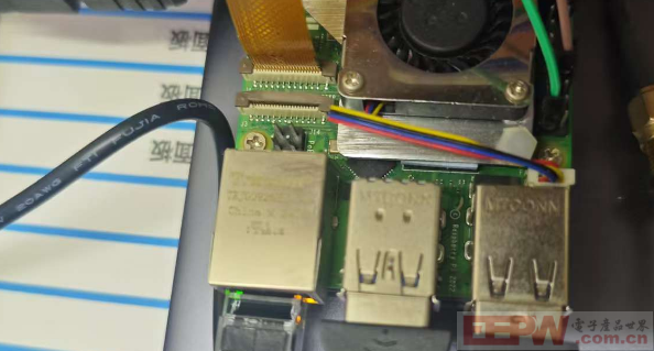

一,环境及硬件连接
CSI摄像头模块 OV5647
fpc金属这边朝向网卡方向

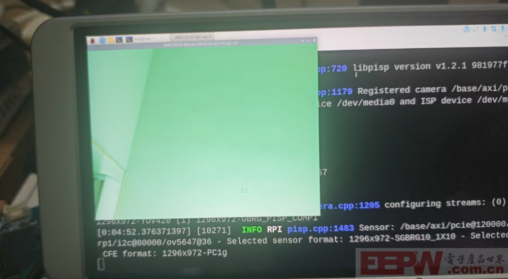

CSI摄像头测试
sudo libcamera-hello -t 0 --camera 0

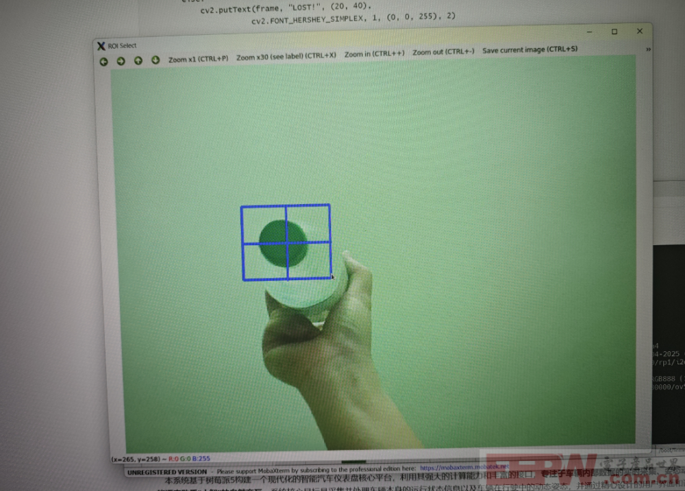

cv2.namedWindow("ROI Select", cv2.WINDOW_NORMAL)
cv2.imshow("ROI Select", frame)
print("..........Enter")
bbox = cv2.selectROI("ROI Select", frame, showCrosshair=True)

main()成果演示
python csrt_csi_usb.py
