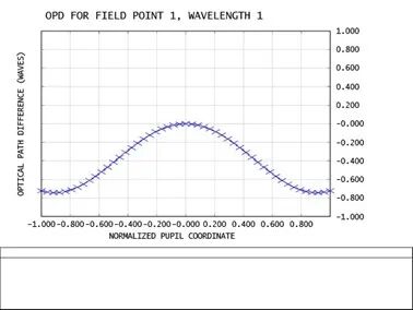

最后,父宏使用关键字PLOT绘制 OPD 与光瞳坐标数据:! Plot dataPLOT NEW
PLOT TITLE, "OPD FOR FIELD POINT 1, WAVELENGTH 1"
PLOT TITLEX, "NORMALIZED PUPIL COORDINATE"
PLOT TITLEY, "OPTICAL PATH DIFFERENCE (WAVES)"
PLOT RANGEX, -1.0, 1.0
PLOT RANGEY, -1.0, 1.0
PLOT DATA, x, y, n_vals, 1, 1, 1
PLOT GO
然后将结果打印到图形窗口:
