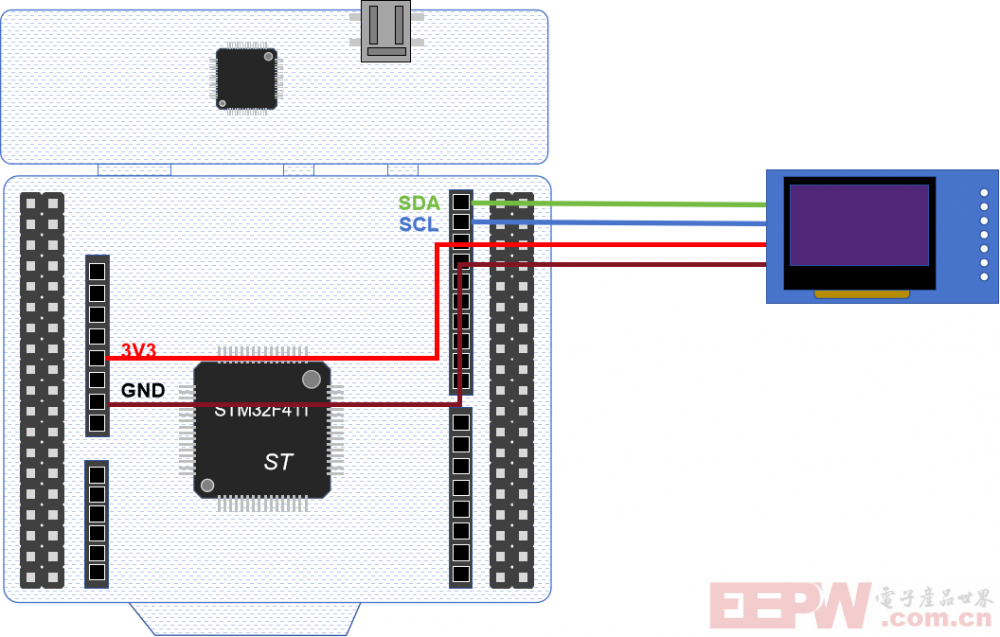

1、连线图

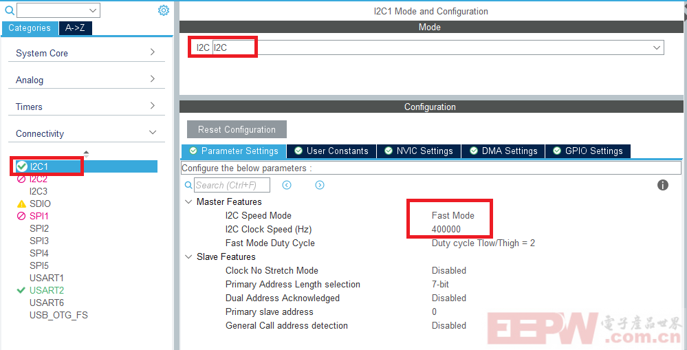

2、I2C配置
static void MX_I2C1_Init(void)
  /* USER CODE BEGIN I2C1_Init 0 */
  /* USER CODE END I2C1_Init 0 */
  /* USER CODE BEGIN I2C1_Init 1 */
  /* USER CODE END I2C1_Init 1 */
  hi2c1.Instance = I2C1;
  hi2c1.Init.ClockSpeed = 400000;
  hi2c1.Init.DutyCycle = I2C_DUTYCYCLE_2;
  hi2c1.Init.OwnAddress1 = 0;
  hi2c1.Init.AddressingMode = I2C_ADDRESSINGMODE_7BIT;
  hi2c1.Init.DualAddressMode = I2C_DUALADDRESS_DISABLE;
  hi2c1.Init.OwnAddress2 = 0;
  hi2c1.Init.GeneralCallMode = I2C_GENERALCALL_DISABLE;
  hi2c1.Init.NoStretchMode = I2C_NOSTRETCH_DISABLE;
  if (HAL_I2C_Init(&hi2c1) != HAL_OK)
    Error_Handler();
  /* USER CODE BEGIN I2C1_Init 2 */
  /* USER CODE END I2C1_Init 2 */

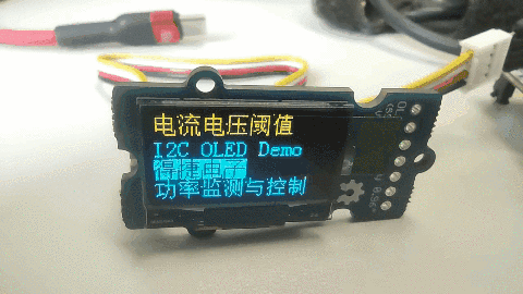

main.c
	OLED_Clear();
	OLED_Copy_Bmp(0,0,128,16,bmp1,0,0);
	OLED_Refresh();
	HAL_Delay(500);
	OLED_Copy_Bmp(0,16,128,16,bmp1,0,16);
	OLED_Refresh();
	HAL_Delay(500);
	OLED_Copy_Bmp(0,32,128,16,bmp1,0,32);
	OLED_Refresh();
	HAL_Delay(500);
	OLED_Copy_Bmp(0,48,128,16,bmp1,0,48);
	OLED_Refresh();
	HAL_Delay(500);
        while (1)
		if(count<128/4)
			OLED_ScrollDisplay(4);
			count++;
		}else
			OLED_ShowChineseString16(0,0,"电流电压阈值",(count)%4);
			OLED_ShowString(0,16,"I2C OLED Demo",16,(count+3)%4);
			OLED_ShowChineseString16(0,32,"得捷电子",(count+2)%4);
			OLED_ShowChineseString16(0,48,"功率监测与控制",(count+1)%4);
			OLED_Refresh();
			HAL_GPIO_TogglePin(LD2_GPIO_Port,LD2_Pin);
			HAL_Delay(1000);
			count++;
