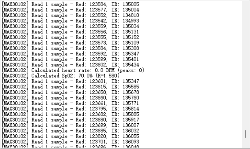

其中的驱动代码:linux/drivers/iio/health/max30102.c at main · analogdevicesinc/linux
根据驱动代码和原理图:MAXREFDES117 | 参考设计 | 亚德诺半导体
这里是.c的驱动代码

// 初始化MAX30102 - 简化版本
max30102_error_t MAX30102_Init(void)
   MAX30102_LOG("[MAX30102] Initializing...\n");
   if (g_initialized) {
       MAX30102_LOG("[MAX30102] Already initialized\n");
       return MAX30102_OK;
   // 读取Part ID验证通信
   uint8_t part_id;
   if (MAX30102_ReadReg(MAX30102_REG_PART_ID, &part_id) != 0) {
       MAX30102_LOG("[MAX30102] Failed to read Part ID\n");
       return MAX30102_ERROR_I2C;
   if (part_id != 0x15) { // MAX30102的Part ID是0x15
       MAX30102_LOG("[MAX30102] Invalid Part ID: 0x%02X (expected 0x15)\n", part_id);
       return MAX30102_ERROR_INIT;
   MAX30102_LOG("[MAX30102] Part ID verified: 0x%02X\n", part_id);
   // 软复位
   MAX30102_WriteReg(MAX30102_REG_MODE_CONFIG, 0x40);
   MXC_Delay(MXC_DELAY_MSEC(10));
   // 设置SpO2模式
   MAX30102_WriteReg(MAX30102_REG_MODE_CONFIG, 0x03); // SpO2模式
   MAX30102_WriteReg(MAX30102_REG_SPO2_CONFIG, 0x27); // 18-bit, 100Hz
   MAX30102_WriteReg(MAX30102_REG_LED1_PA, 0x24);     // 红光 ~7mA
   MAX30102_WriteReg(MAX30102_REG_LED2_PA, 0x24);     // IR ~7mA
   g_initialized = true;
   MAX30102_LOG("[MAX30102] Initialization completed successfully\n");
   return MAX30102_OK;

// 简化的FIFO读取函数 - 参考优化版本
max30102_error_t MAX30102_ReadFIFO(max30102_sample_t *samples, uint8_t *num_samples)
   if (!g_initialized || samples == NULL || num_samples == NULL) {
       return MAX30102_ERROR_PARAM;
   // 直接读取一个样本(6字节)
   uint8_t buf[6];
   int ret = MAX30102_ReadMulti(MAX30102_REG_FIFO_DATA, buf, 6);
   if (ret != 0) {
       *num_samples = 0;
       return MAX30102_ERROR_FIFO_EMPTY;
   // 解析数据 - 使用18位掩码
   samples[0].red = ((uint32_t)buf[0] << 16) | ((uint32_t)buf[1] << 8) | buf[2];
   samples[0].ir = ((uint32_t)buf[3] << 16) | ((uint32_t)buf[4] << 8) | buf[5];
   samples[0].green = 0; // 在SpO2模式下不使用绿色LED
   // 应用18位掩码
   samples[0].red &= 0x3FFFF;
   samples[0].ir &= 0x3FFFF;
   *num_samples = 1;
   MAX30102_LOG("[MAX30102] Read 1 sample - Red: %lu, IR: %lu\n",
                samples[0].red, samples[0].ir);
   return MAX30102_OK;

// 改进的心率计算算法(基于信号处理和峰值检测)
max30102_error_t MAX30102_CalculateHeartRate(float *heart_rate, uint32_t *red_buffer, uint32_t *ir_buffer, uint16_t buffer_length)
   if (heart_rate == NULL || red_buffer == NULL || ir_buffer == NULL || buffer_length < 50) {
   // 使用IR信号进行心率计算(更稳定)
   uint32_t *signal = ir_buffer;
   // 1. 简单的移动平均滤波
   uint32_t filtered_buffer[100]; // 固定大小,足够大
   for (uint16_t i = 2; i < buffer_length - 2; i++) {
       filtered_buffer[i] = (signal[i-2] + signal[i-1] + signal[i] + signal[i+1] + signal[i+2]) / 5;

读数据将数据通过串口打印出来
#include <stdio.h>
#include "board.h"
#include "mxc_device.h"
#include "mxc_delay.h"
#include "i2c.h"
#include "max30102.h"
// 函数声明
static int init_hardware(void);
static void print_sensor_data(void);
// static void handle_error(max30102_error_t error, const char* function);
// 数据缓冲区
#define BUFFER_SIZE 100
static uint32_t red_buffer[BUFFER_SIZE];
static uint32_t ir_buffer[BUFFER_SIZE];
static uint16_t buffer_index = 0;
int main(void)
   printf("MAX78000 + MAX30102 Heart Rate & SpO2 Monitor\n");
   printf("==============================================\n");
   // 初始化硬件
   if (init_hardware() != 0) {
       printf("Hardware initialization failed!\n");
       return -1;
   printf("\nPlace your finger on the MAX30102 sensor...\n");
   printf("Collecting data for analysis...\n\n");
   // 主循环 - 改进版本
   uint32_t loop_count = 0;
   uint32_t last_print_time = 0;
   uint32_t consecutive_valid_reads = 0;
   max30102_sample_t samples[1]; // 每次读取一个样本
   uint8_t num_samples = 1;
   printf("\n=== 开始数据采集 ===\n");
   printf("请将手指稳定放置在传感器上,保持静止...\n\n");
   while (1)
       // 读取MAX30102数据
       max30102_error_t error = MAX30102_ReadFIFO(samples, &num_samples);
       if (error == MAX30102_OK && num_samples > 0) {
           // 数据质量检查
           if (samples[0].red > 1000 && samples[0].ir > 1000) { // 基本数据有效性检查
               // 将数据存储到缓冲区
               if (buffer_index < BUFFER_SIZE) {
                   red_buffer[buffer_index] = samples[0].red;
                   ir_buffer[buffer_index] = samples[0].ir;
                   buffer_index++;
                   consecutive_valid_reads++;
               // 当缓冲区满时,计算心率和SpO2
               if (buffer_index >= BUFFER_SIZE) {
                   max30102_hr_spo2_t result;
                   float signal_quality;
                   if (MAX30102_CalculateHRSpO2(&result, red_buffer, ir_buffer, BUFFER_SIZE) == MAX30102_OK &&
                       MAX30102_AssessSignalQuality(&signal_quality, red_buffer, ir_buffer, BUFFER_SIZE) == MAX30102_OK) {
                       // 控制打印频率 - 每2秒打印一次
                       if (loop_count - last_print_time >= 200) { // 200 * 10ms = 2秒
                           print_sensor_data();
                           if (result.valid && signal_quality > 60.0f) {
                               printf("✓ 心率: %.1f BPM, 血氧: %.1f%%\n",
                                      (double)result.heart_rate, (double)result.spo2);
                               printf("信号质量: %.1f%% (连续有效读数: %lu)\n\n",
                                      (double)signal_quality, consecutive_valid_reads);
                           } else {
                               printf("✗ 数据质量不佳 - 请调整手指位置\n");
                               printf("  心率: %.1f BPM, 血氧: %.1f%%\n",
                               printf("  信号质量: %.1f%% (需要 > 60%%)\n", (double)signal_quality);
                               printf("  建议: 保持手指稳定,避免移动,确保完全覆盖传感器\n\n");
                           last_print_time = loop_count;
                   // 重置缓冲区
                   buffer_index = 0;
           } else {
               consecutive_valid_reads = 0; // 重置连续有效读数计数
       } else if (error == MAX30102_ERROR_FIFO_EMPTY) {
           // FIFO为空,继续等待
       } else {
           printf("MAX30102 读取错误: %s\n", MAX30102_GetErrorString(error));
       // 每500次循环显示一次状态(5秒)
       if (++loop_count % 500 == 0) {
           printf("状态: 循环 %lu, 缓冲区 %d/%d 样本, 连续有效读数: %lu\n",
                  loop_count, buffer_index, BUFFER_SIZE, consecutive_valid_reads);
       MXC_Delay(MXC_DELAY_MSEC(10)); // 10ms延迟
   return 0;
// 初始化硬件
   printf("Initializing hardware...\n");
   // 初始化I2C
   int res = MXC_I2C_Init(MXC_I2C1, 1, 0);
   if (res != 0) {
       printf("I2C Init failed: %d\n", res);
       return -1;
   printf("✓ I2C Init: OK\n");
   MXC_I2C_SetFrequency(MXC_I2C1, 400000);
   printf("✓ I2C Frequency: %d Hz\n", MXC_I2C_GetFrequency(MXC_I2C1));
   // 初始化MAX30102
   max30102_error_t error = MAX30102_Init();
   if (error != MAX30102_OK) {
       printf("✗ MAX30102 Init failed: %s\n", MAX30102_GetErrorString(error));
       return -1;
   printf("✓ MAX30102 Init: OK\n");
   // 读取Part ID验证
   uint8_t part_id;
   if (MAX30102_ReadPartID(&part_id) == MAX30102_OK) {
       printf("✓ MAX30102 Part ID: 0x%02X\n", part_id);
   printf("\n✓ Hardware initialization completed successfully!\n");
   return 0;
// 打印传感器数据
   printf("\n--- Sensor Data Analysis ---\n");
   printf("Buffer Status: %d/%d samples collected\n", buffer_index, BUFFER_SIZE);
       printf("Status: Collecting data... Please keep finger on sensor\n");
   } else {
       printf("Status: Processing data... Calculating HR & SpO2\n");
   // 显示原始数据(最后几个样本)
   if (buffer_index > 0) {
       uint16_t last_index = (buffer_index > 0) ? buffer_index - 1 : 0;
       printf("Latest Sample - Red: %lu, IR: %lu\n",
              red_buffer[last_index] >> 4, ir_buffer[last_index] >> 4);
   printf("----------------------------\n");
image-20251003122131629
实物图
