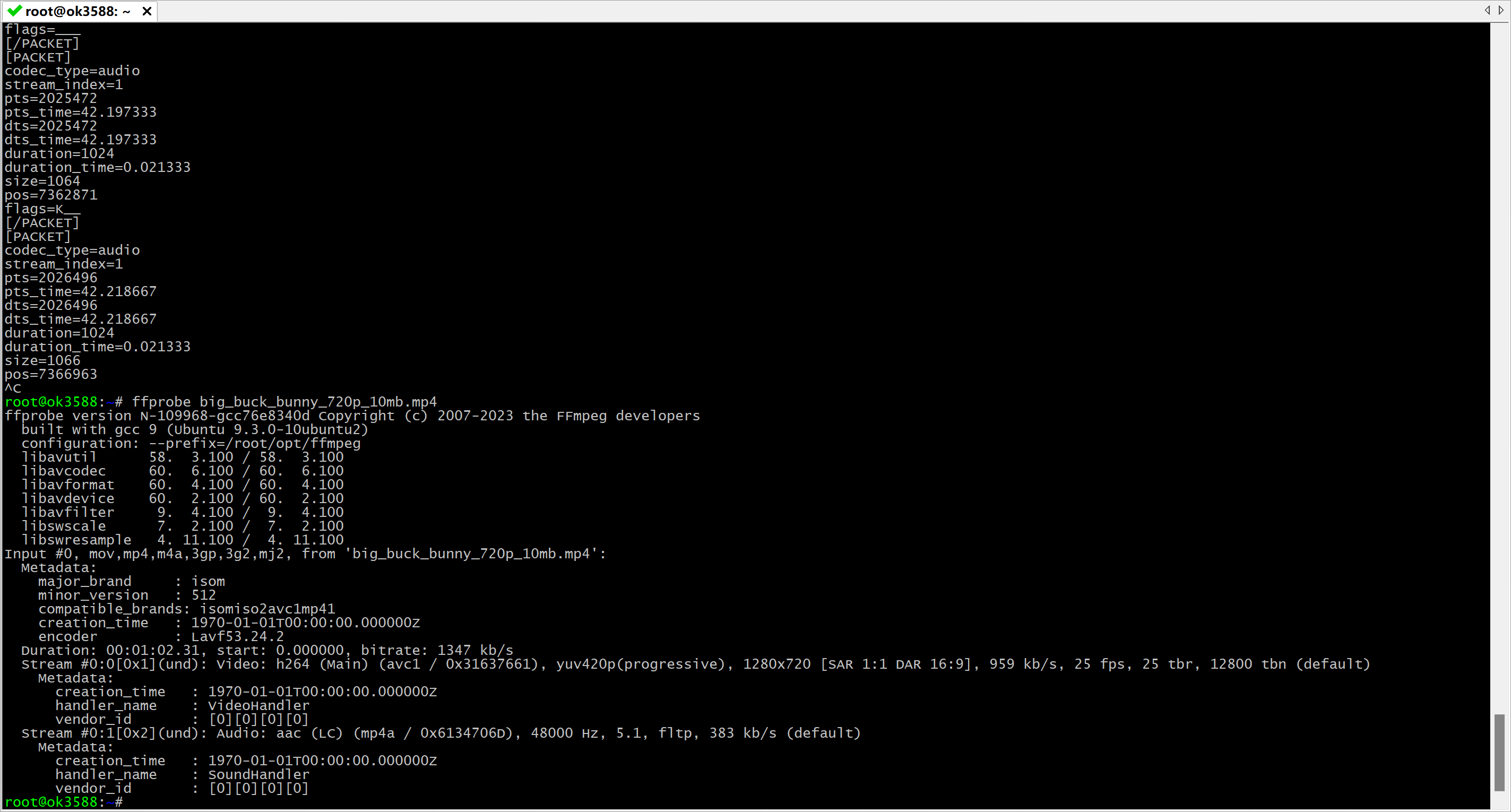

Ffprobe使用
    root@ok3588:~# ffprobe big_buck_bunny_720p_10mb.mp4
    ffprobe version N-109968-gcc76e8340d Copyright (c) 2007-2023 the FFmpeg developers
      built with gcc 9 (Ubuntu 9.3.0-10ubuntu2)
      configuration: --prefix=/root/opt/ffmpeg
      libavutil      58.  3.100 / 58.  3.100
      libavcodec     60.  6.100 / 60.  6.100
      libavformat    60.  4.100 / 60.  4.100
      libavdevice    60.  2.100 / 60.  2.100
      libavfilter     9.  4.100 /  9.  4.100
      libswscale      7.  2.100 /  7.  2.100
      libswresample   4. 11.100 /  4. 11.100
    Input #0, mov,mp4,m4a,3gp,3g2,mj2, from 'big_buck_bunny_720p_10mb.mp4':
      Metadata:
        major_brand     : isom
        minor_version   : 512
        compatible_brands: isomiso2avc1mp41
        creation_time   : 1970-01-01T00:00:00.000000Z
        encoder         : Lavf53.24.2
      Duration: 00:01:02.31, start: 0.000000, bitrate: 1347 kb/s
      Stream #0:0[0x1](und): Video: h264 (Main) (avc1 / 0x31637661), yuv420p(progressive), 1280x720 [SAR 1:1 DAR 16:9], 959 kb/s, 25 fps, 25 tbr, 12800 tbn (default)
        Metadata:
          handler_name    : VideoHandler
          vendor_id       : [0][0][0][0]
      Stream #0:1[0x2](und): Audio: aac (LC) (mp4a / 0x6134706D), 48000 Hz, 5.1, fltp, 383 kb/s (default)
        Metadata:
          handler_name    : SoundHandler
    root@ok3588:~#
ffprobe -show_data big_buck_bunny_720p_10mb.mp4ffprobe -show_packets big_buck_bunny_720p_10mb.mp4ffprobe -show_format big_buck_bunny_720p_10mb.mp4ffprobe -show_frames big_buck_bunny_720p_10mb.mp4
