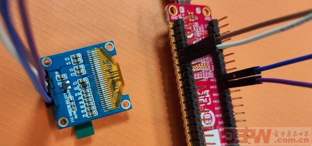

硬件连接
开发板的 PA12、PA13 引脚分别对应 OLED 的 SDA 和 SCL 引脚。
OLEDSAM E51
SDAPA12
SCLPA13
VCCVTG
GNDGND

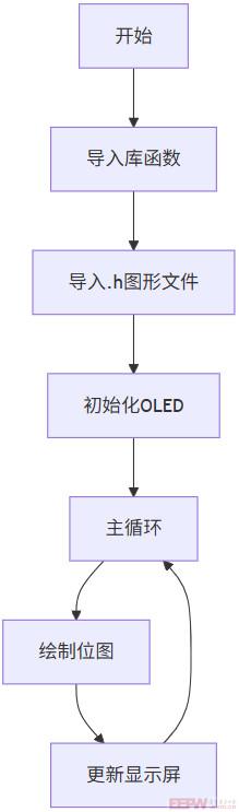

流程图

#include <OLED_Display_SSD1306.h>
#include "bitmap.h"
void setup() {
  OLED_Display_SSD1306_init();  // Initialize the OLED display
void loop() {
  OLED_Display_SSD1306_drawBitmap(0, 0, bitmap_microchip, 128, 64, 1);  // Draw bitmap at position (0, 0) and size of 32x32 pixels more than it will overload the RAM
  // Use chunking to display full screen bitmaps
  OLED_Display_SSD1306_display();  // Update the display
